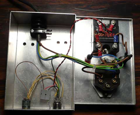

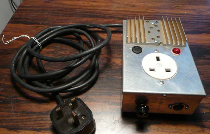

That being said, with care, a simple SSR box is not hard. The pictures attached show an old one of mine. It needs an update in that I used a 5 pin DIN connector as input, the switch letting me select 1 of 4 channels of plain hard wired drive, (all my old lightshow gear used DIN’s to keep the cost down), note the recycled heat sink! In those days I had no MIDI, and used the 270o DIN for power, and the 180o for control. I’m going to change to another plug to avoid confusion, though plugging a MIDI plug into the socket on here would be completely safe, only 1 pin at a time is connected. +5V with respect to  ground (Pin 3), turned the SSR  on. I did other boxes with 4 SSR’s, though I think they found a final resting place in a club in Manchester when I stopped doing that sort of mobile stuff, years ago. A design using modern mains out connectors would not be hard, though the hardware cost would not be that cheap.
