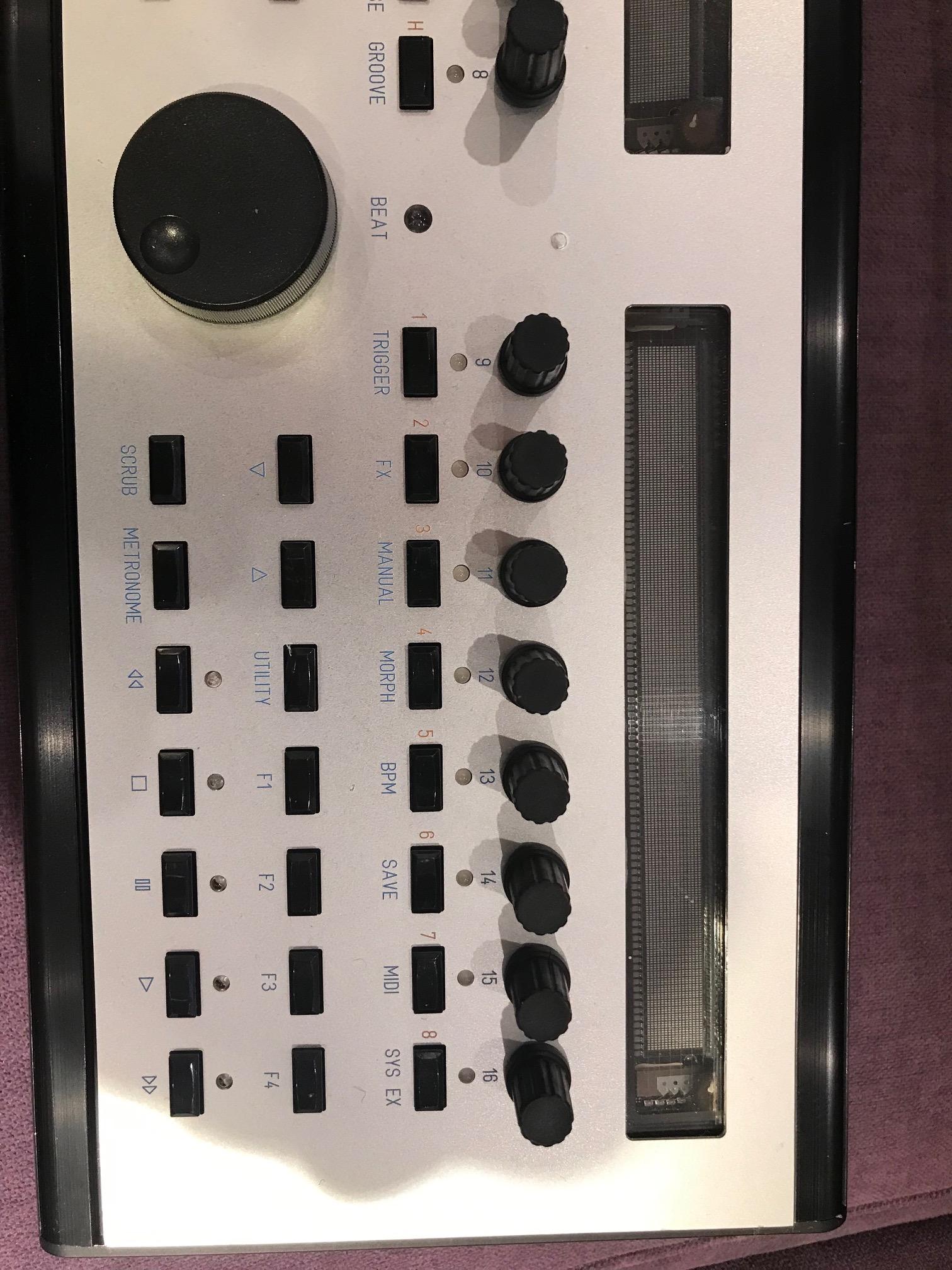

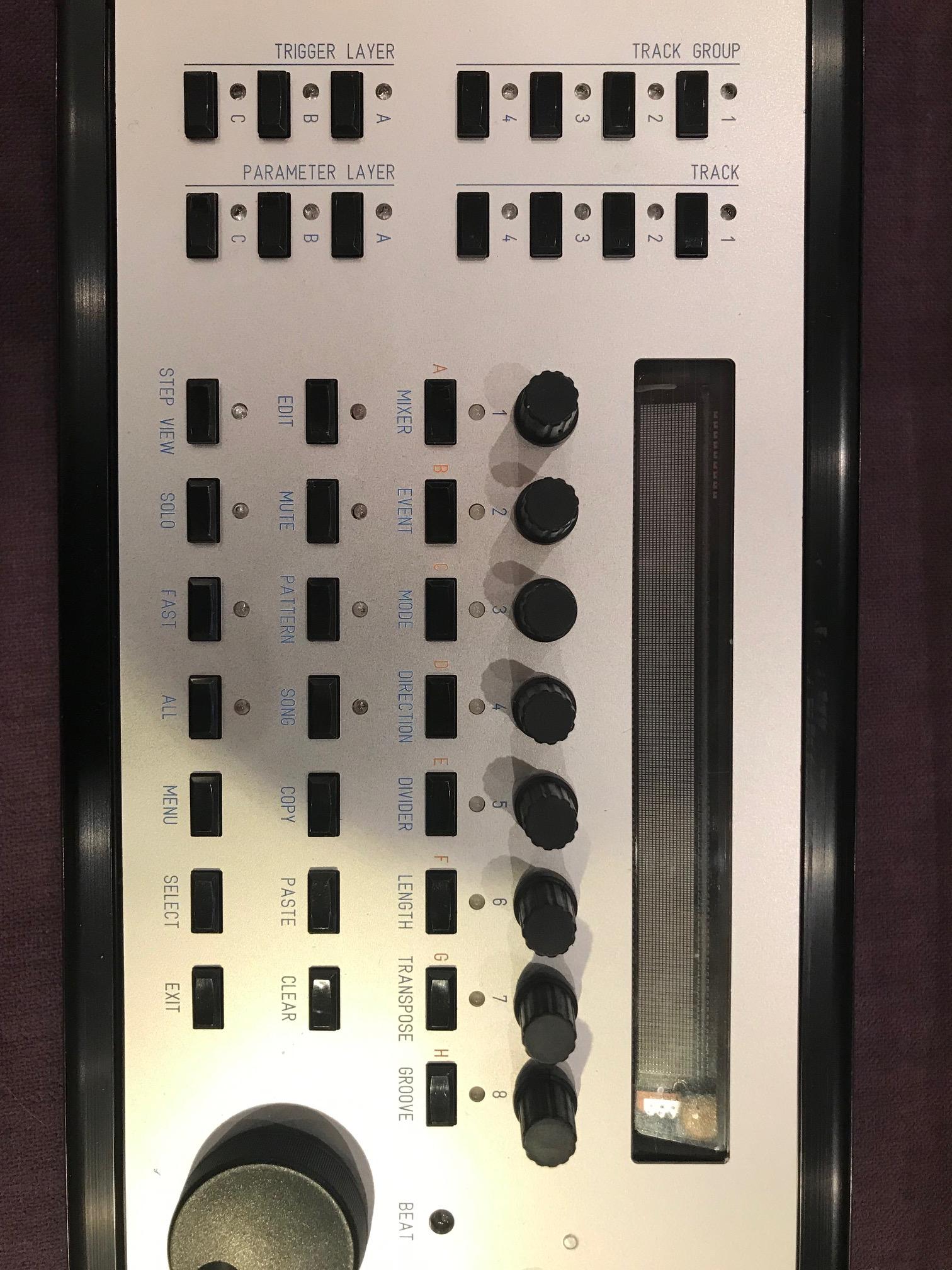

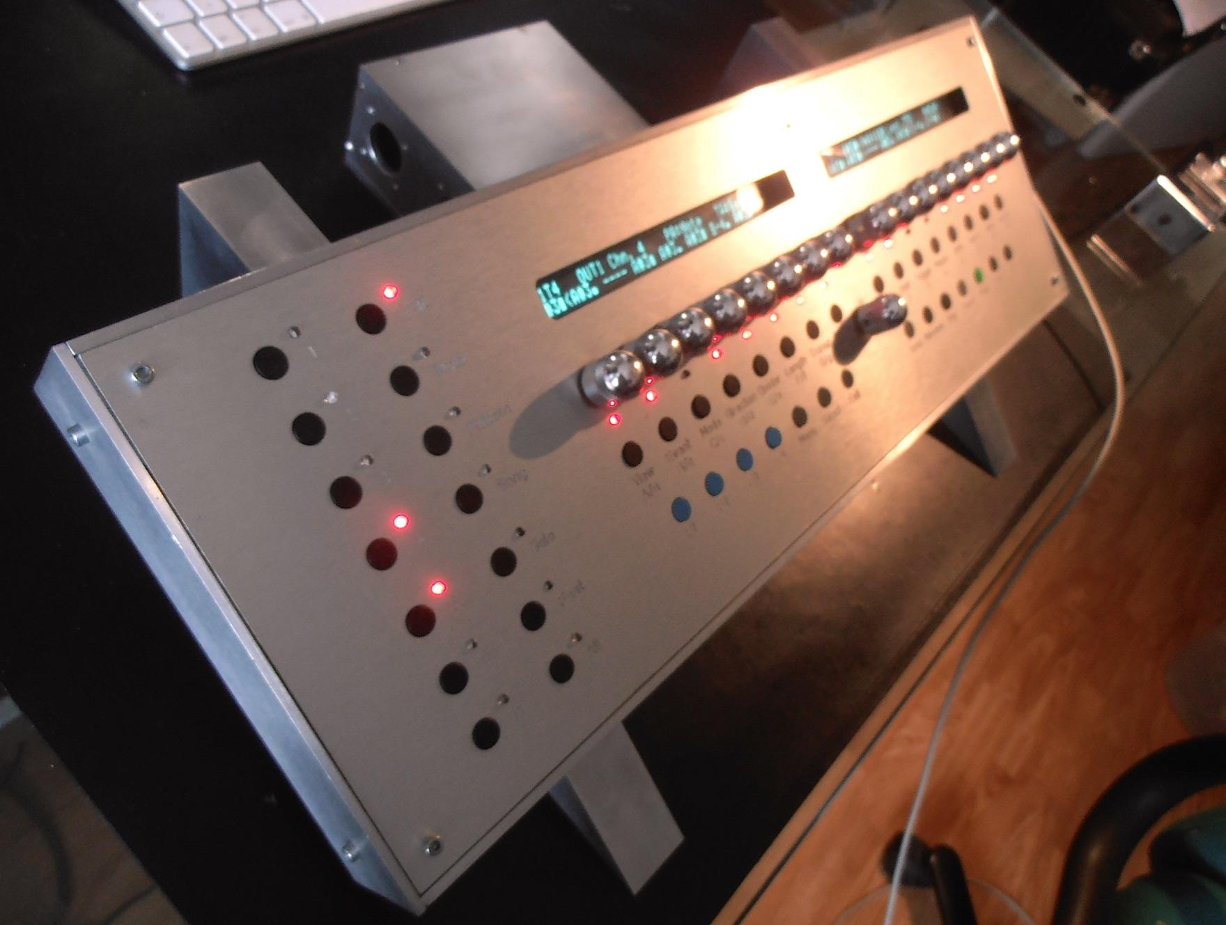

show me the connection panel of the device - so i see for what Core - Line-Trans it is build for…
You can find it under: Trace: • wilba_mb_seq_construction_guide
nope i cant find it - this is only the frontpanel.
i need too see your backpanel - aka the housing aka the aluminium plate for the connections… - about software: there is still a firmware for 4.096 so yes possible…

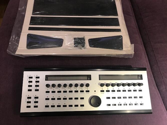

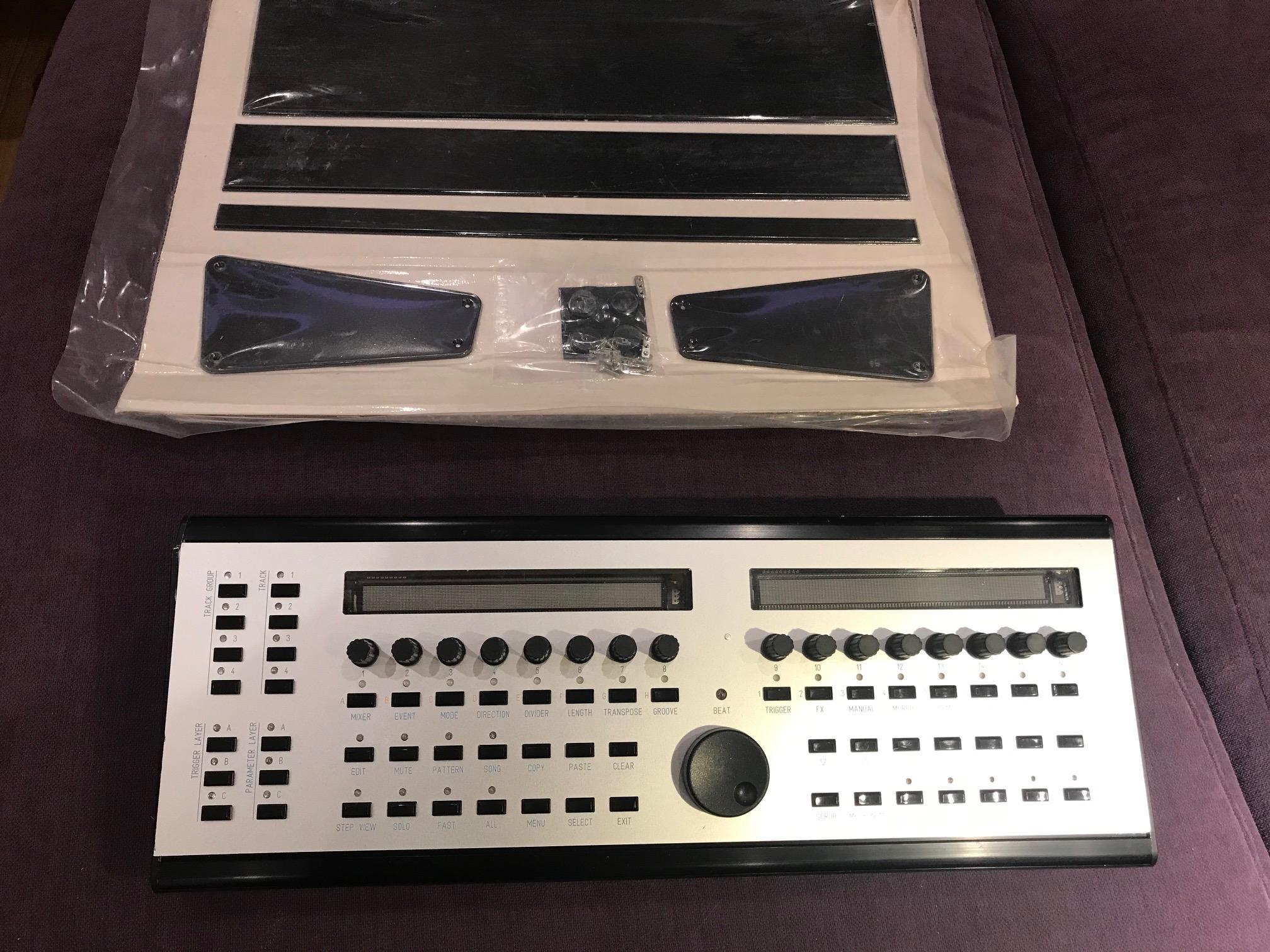

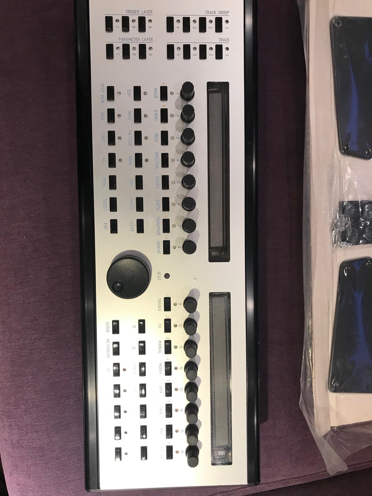

By the way, I have the feeling that’s exactly the panel that you have according to that link:
< base_url >/topic/21211-wilba-seq-fpanel-2x-button-caps-needet/?do=embed&comment=185181&embedComment=185181&embedDo=findComment#comment-185181
nope that is a plastic case made by ponoko… so why you dont post the panel - else i am out!

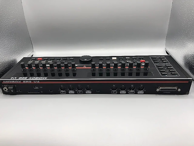

why you want to use the midiphy core? use the orginal core? I ask because i have booth at home the lpc17 core (need different packbanel) the stm32F4 core '(need different backpanel)… the orginal stm32F4 core use the same microcontroller on a different developement board - like the waveshare from midiphy… … i too have the linedriver pcb… i have a whole midibox labor with assembled modules at home - but if you wont show the backpanel - i cant help you anyway…

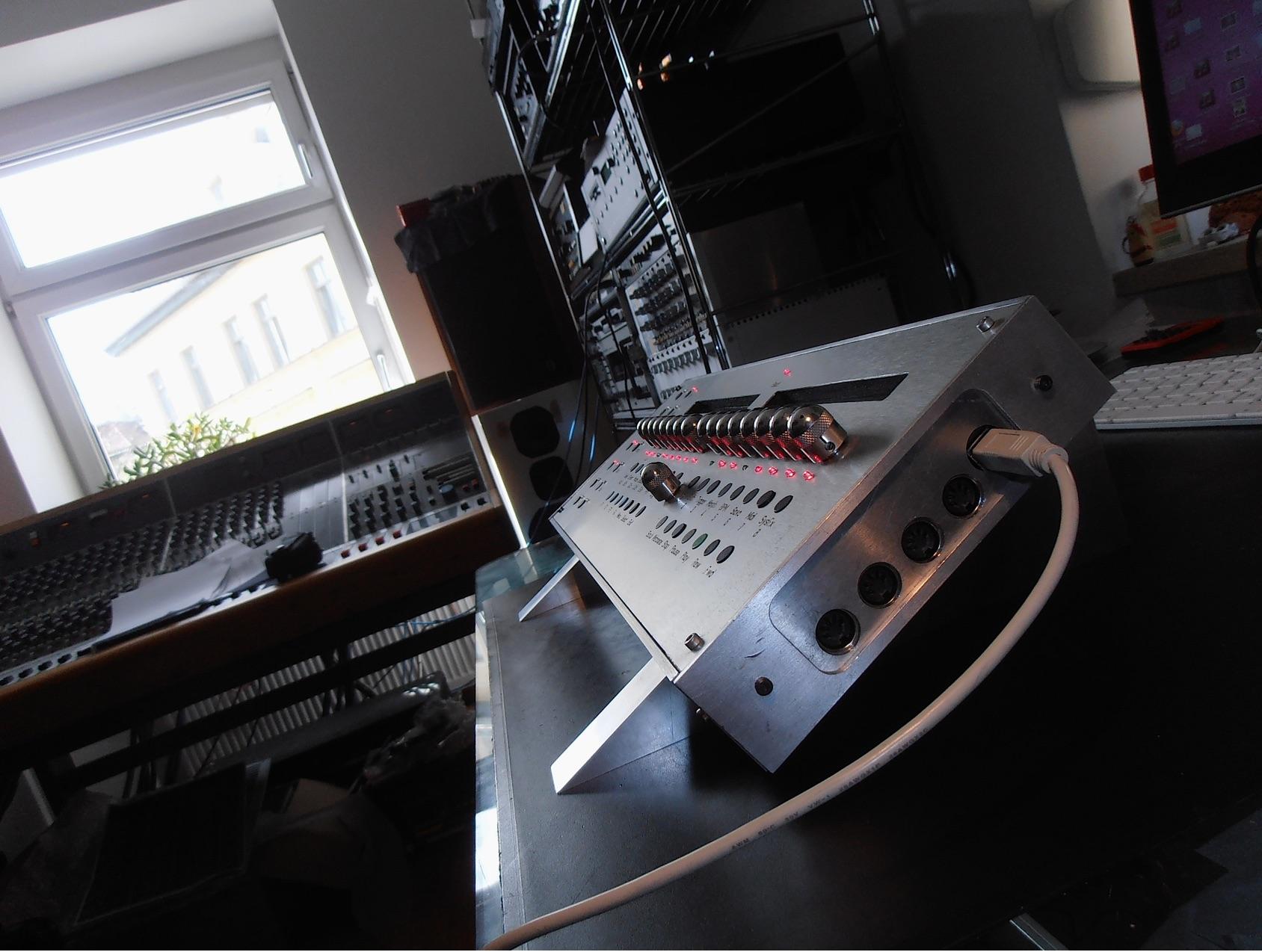

diese Rückansicht z.B.
 ist für ein core stm32F4… und ist offensichtlich für 2x Midi IO Module geschaffen
für diese ausführung hätte ich alles daheim, bis auf das zweite MIDI IO…

I don’t have any back Panel on this one. On the silver one I have a side Panel, but it is not here right now.
I want to get the maximal Midi port amount as possible. I would like to update as well with the the CV/Gate directly but for the beginning, it is not a must. SD port on the back as well. Sync Roland for old drum/Sequencers.
