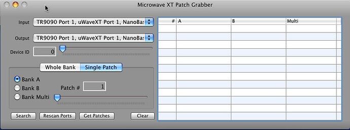

Ok here we go.  While it’s far from done, it is at least doing something usable now, and demonstrated using the PYMIDI framework.  There are three attachments below.

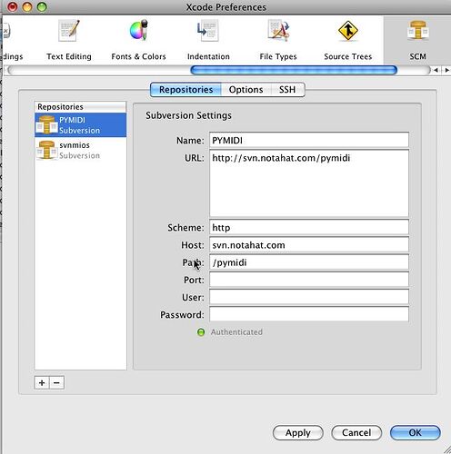

  1. Shows you how to setup xcode to get the PYMIDI source.. its super simple to make a framework project for this code, but I’m lazy and don’t feel like going into those details.  Just use the framework that I’ve already built and reference this code to see how it works.  http://notahat.com/pymidi

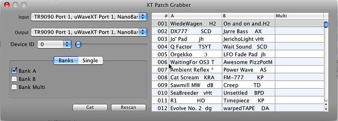

  2. XT Patch Grabber 2008.zip  - This is is my code tree for the patch name grabber app.  Currently, the search button works very nicely.  When you click search, it will setup a timer and send a LCD screen request to all of your MIDI output ports to located the first Waldorf XT that responds.  Additionally, it tries all device ID’s starting from zero and incrementing to 126 until it gives up.
The window saves all of its setting, but for some reason it never saves the setting unless its an item that the user has clicked on.  This means that it doesn’t save the selected ports and device id that it determined from a scan.
The app is probably pretty close to grabbing patch names, but I want to build it all the correct cocoa way and not use char pointers all over the place.  At least it shows you how to deal with the endpoint lists and sending and receiving midi.  If you have a microwave XT and want help out with this, let me know.
** UPDATE 2008-10-07 **

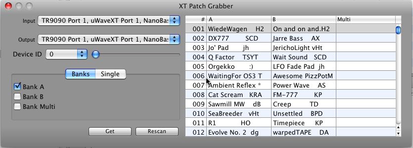

XT Patch Grabber.2008.zip  - contains memory leak fixes and now actually grabs patch names in both batch and single patch mode.

For those that care, I’ve updated the patch grabber zip file in my post above.  It’s now much much better, and is about 80-90% functional.  You will want to reference this version because the last post had memory leaks and was pretty incomplete.
