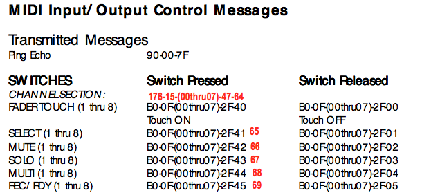

There is a other thing i can’t understand. If i touch a Fadercap i generate a similar message. But it seams to have a Ping going with it as well witch is described in this document. The thing i can’t follow is the number 68-75 (90 68 7f)
Here is a copy of the messages transmitted by touching 2 Fadercaps in follow:

Ok, I found my old notes from my “Motormix Studies” with cubase I did a few years ago and I think I can dare to take a shot at this:
For every button there has to be sent 2 CCs, the first one selects the channel and the second one sets the function (like solo, mute,…).
Now, if I remember correctly, the 2 CCs have to be sent twice (so 4 events in total) with different values to set a function.
CC VALUE
Fader Touch:
15     0(0-7)
47     64
15     0(0-7)
47     00
Select:
15     0(0-7)
47     65
15     0(0-7)
47     01
Mute:
15     0(0-7)
47     66
15     0(0-7)
47     02
Solo:
15     0(0-7)
47     67
15     0(0-7)
47     03
Multi:
15     0(0-7)
47     68
15     0(0-7)
47     04
Record:
15     0(0-7)
47     69
15     0(0-7)
47     05
Regarding the PING, I think you can ignore it for now. The Mackie Protocol too has some kind of PING thingie integrated but I didn´t have any trouble ignoring it (at least with Reaper and Ableton).
