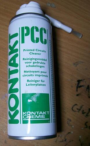

Hi Midiboxers,
i asked my electronic dealer of trust for something to clean my boards.
He advised me this:
“PCC” from Kontakt Chemie.
It was quiet expensive 12€/200ml
But this stuff is really amazing and very, very fertile.
Unfortunately i have cleand all my boards now so i can not show
you some “before/after” pictures :smile: I will post some later.
Best regards
Marxon
No kidding, Marxon, even in Conrad the price is 12E for 400ml, 8.68E for 200ml, I just bought one this week :slight_smile: And, in case you can’t find it, in Germany it’s called ‘LR’ (Leiterplattenreiniger) instead of ‘PCC’ (Printed Circuit board Cleaner). +1 to recommend!
OK i should compare the price before…:confused:
I’ll speak to him the next time.
Thanks Freddy
