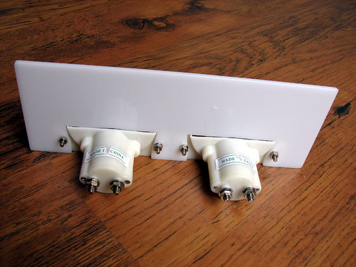

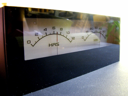

Chronulator (cool meter clock kit)
Some time ago I ordered interesting kit from share brained technologies www.sharebrained.com
It is meter clock driven by TI microcontroller MSP430F2002. Very simple, coffee brake project.
Even It looks very cool as is, I wanted to do extreme customization. The most critical job was disassembling meter and taking out all delicate parts so I can trim it in order to screw both meters to the panel that is going to be back illuminated for extra coolness.  :wink: The project is almost finished… I need back door wih 2 LEDs for illumination. The back panel on pictures is illuminated by daylight not LEDs.

Nice!
I need to get a laser guy! I met someone last week who gave me details for a local company so hopefully I can become his best friend :smiley:
What material did you use for the case… polystyrene??? It looks like the stuff we used to use at school for cases (and thinner for the vacuum former), but I’ve not managed to come across any for sale in this country.
              G
Thank you.
I use only casted acrylic! I don`t believe polystyrene is good enough.
You and the rest of us!

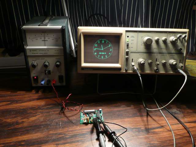

I have to own up to being a bit of an unusual clock fetishist. I just saw this and Dammit! they’re sold out.
My last unusual clock was this one, from http://dutchtronix.com/ScopeClock.htm#FirmwareV3
Ive been dreaming of building scope clock since Ive seen it for the first time. Such a cool looking clock.  Ofcourse it must be standalone and not just plug-in for oscilloscope.
