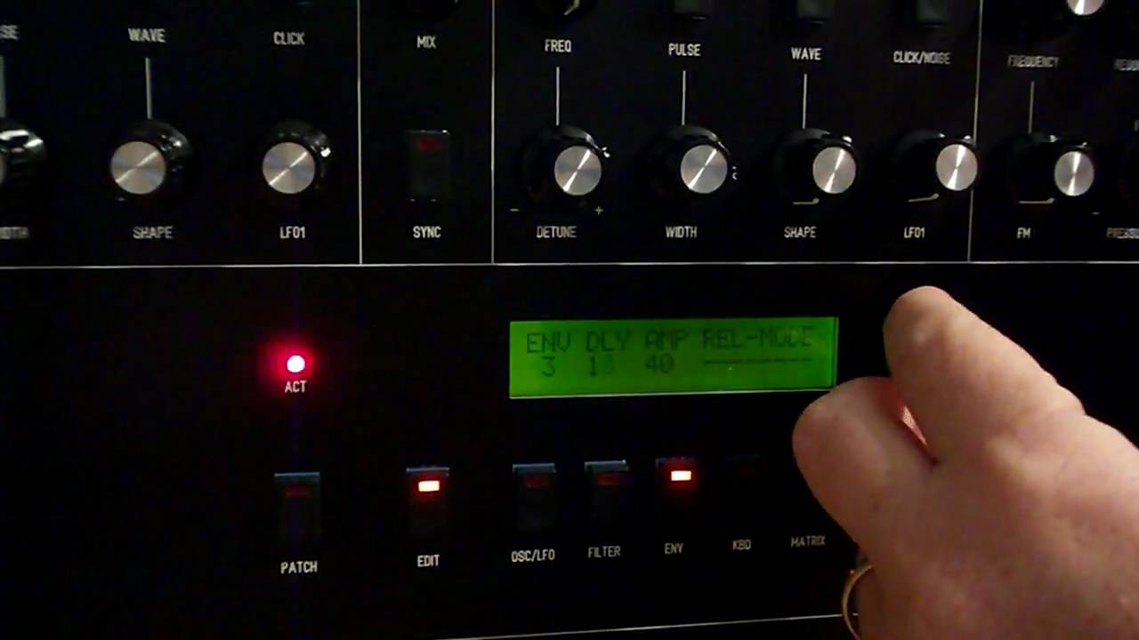

I’m announcing my project here which is currently still under development.
The Chaos Matrix is a control surface and programmer for an Oberheim Matrix 1000 synthesizer. It uses a Core, 1 DIN, 1 DOUT and 1 AIN module. Its loaded with MIOS v1.9c on a PIC18F4620 microprocessor along with a custom application built with the C skeleton interface.
Current Status as of 04/08/2010:
  • Rear panel with MIDI & power jacks
  • Software is complete, sourcecode attached to this post.
  • How-To currently being documented
Wooden cabinet construction aided by this diy howto.
You Tube demonstration (part 1 of 3)
I’m also working on its own wiki here:
http://www.midibox.org/dokuwiki/doku.php?id=chaos_matrix
Front Panel Express file attached to this post.
First, I want to thank Thorsten Klose and all the forum regulars who have contributed their time and talents to the community. Without them, I would have never started building something like this.
Now back to the Chaos Matrix.
Some of you know about how nice these classic synths sound, especially ones using Curtis chips. Unfortunately the Oberheim Matrix 1000 (which is very affordable) offers no way to create your own patches without the use of an editor/librarian on a PC.
So, building a programmer like this brings new life to the synth, allowing me to take full advantage of its awesome matrix modulation capabilities.

I was more inspired by this monster when it came to the panel design.
http://www.vintagesynth.com/oberheim/new_oberheim_obx.jpg
Download the FrontPanel Express file attached to the original post, you can see which controls I decided to dedicate to a pot or button. All the other controls are accessed through the soft panel (lower half).
On my wiki, you can see a photo of the prototype… which had a LOT more dedicated controls. I later decided to simplify it.
