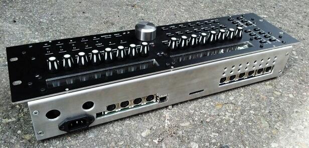

I use a hard plastic modular 3u rack mount case from my local electronics store and a ponoko front plate too. The case needed a little bit of dremeling, but it is a perfect fit now.
Need to see a pic of that…
The lower part with the drum pads is not shown in this image, and the side panels are not mounted yet. I’ll publish another picture when it’s finally ready :smile:
