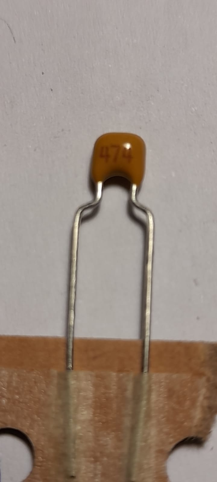

capacitor 223, 474
Hi I’m new here! :slight_smile: I hope I’m in the right place to ask … Capacitor 223 is correct in c3_sid, c7_sid, c23_sid, c27_sid and capacitor 474 is correct in c4_sid, c24_sid thanks greetings from mallorca

PS: 223 is probably 22 * 10^3 pF = 22 nF
474 = 47 * 10^4 = 470 nF, i could be wrong in nano or pico, but i am sure you will find that out, the principle remains true

22 and 470nF it is.
