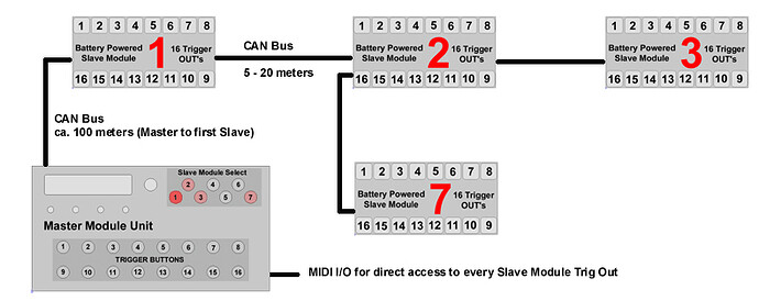

My idea is to use a Master Unit Controller wich I can select the Slave Modules and trig the DOUT of the selected Slave Module. In addition I use an MIDI I/O to control every DOUT of every attached slave in realtime. The Slave Modules would be linked with Master over the CAN Bus (long distance)

Have made a picture for better visualisation
