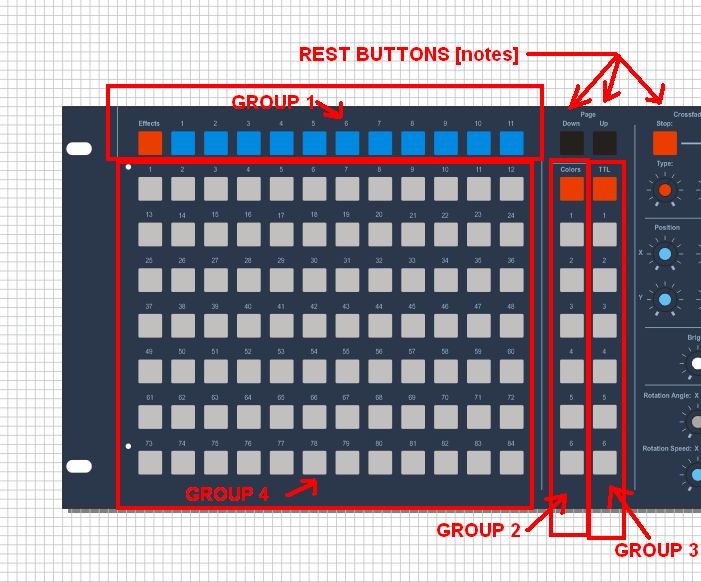

I’m looking for somebody who can help me with led groups for buttons [notes]
example:
While pressing button #1 - the led under the button will turn on
While pressing button #6 - the led under the button #1 will turn off and the led under button #6 will turn on
I have one group of 10 buttons with leds and another group of 10 buttons with leds, and i want that groups of leds work independently. So that, when I push the button from 1st group and the button from 2nd group, they both led will be turn on. But when I turn on, for example, the other button from 2nd group, the led from the 2nd group will switch(the new one will be now shinning) but in the 1st group nothing will change.
My controller (check the enclosure):
group 1:
90x00
90x01

Group 2:
90x1C

Group3:
90x1D

Group4:
90x10

NEXT  NOTES Of WHAT I NEED:
90x0C

But leds for that and rest notes must be like that, I push the button>led turn on, I push the button again (turn off the effect)>led turn off
Can anyone help me to change ain64_din128_dout128_v1_3 code?
I hope, that all i wrote, it’s not too knotty..
Best Regards
Waiting for proposition

what you are asking for (I think, I’m a bit confused from the explaination) is very easy to do in C.
Find the function that is triggered when a midi note is received.
Build a switch or series of If statements that catch the note value.
Turn LED on or off according to a flag (variable) for each LED
Then reset the flag.
easy!
