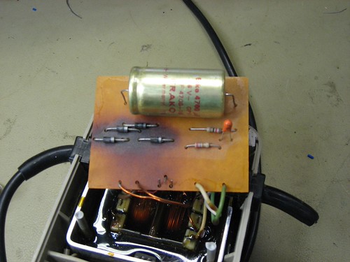

Here’s two pics of and old PSU which I opened to see whether you could build a new one inside it. Verdict: not really.
Here’s the “transformer side”. The regulator is mostly inside the glue or whatever, so in practice it cannot be replaced. The fuse is on the mains side.
Here’s the PCB. Check out the rectifier :slight_smile:

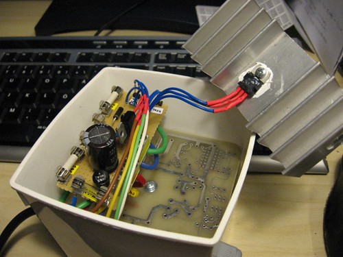

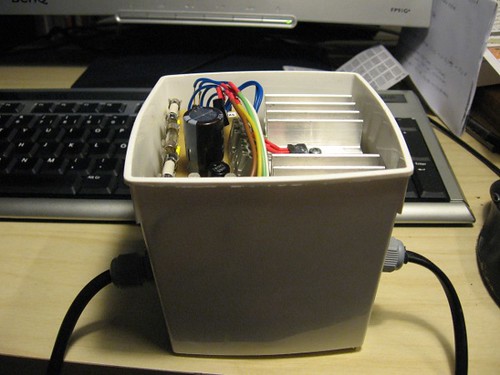

I built myself a new one out based on a toroidal transformer I found at work, and retro-donald’s design (http://www.retro-donald.de/pages/hardware/basteleien/powernetzteil.php). The toroid puts out almost 11VAC per coil (nominally 9VAC), so there’s a lot to regulate after rectification (15VDC->5VDC); the total power consumption of a 4-core MBSID is about 18-19W, and the cooling element of the regulator gets very hot (you can’t touch it longer than a few seconds after half an hour). I also had to put a small cooling element on the regulator inside the midibox which regulates 16VDC->9VDC, which doesn’t get too hot though. (Will send more pics when I get home!)
The regulator I used can take 2A, and according to my measurements a 4-core MBSID with completele control surface doesn’t exceed 1,5A (on the 5VDC side); I guess I’m going to consider a bigger cooling element just to make it sure.

Here’s what I built. From the outside:
..and inside. The toroid is under the rubbish PCB.
