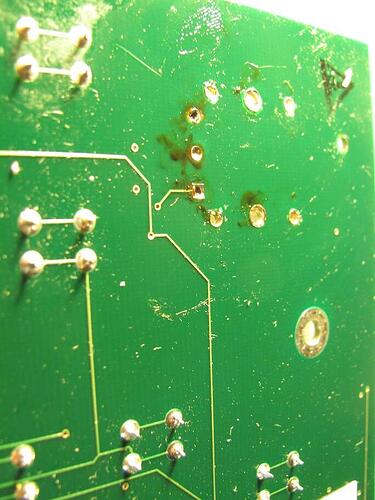

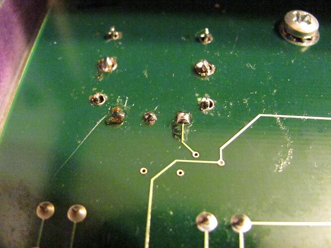

I broke the middle pin trace by melting the pcb a little. So I scraped off some of the mask where the data line is which is going to a mini resistor and made a joint with cut resistor leads. The only problem is it still does not work :frowning:
I can’t find the encoder pin out right now but looking from top down with the knob at the top, the left pin does not seem to go anywhere, the middle pin goes to the resistor and the right pin goes to ??? I see a data line but it goes to a empty tiny pad hole. I am afraid this might be a multi layer board.
What would be the best way to handle this now? Should I run wires from the encoder to the board or possibly retrace the board (can this be done)?

So first picture shows the small resistor that the middle pin is going to.
2nd pic is the underside.
3rd pic shows the thickness of the board (is it multilayer?)
And the last two are top side.
I may need to take off the front panel to fix this now. Can you confirm that the left side pin (looking from topside) is not connected to anything? o me it looks like only the middle pin (to the resistor) and the right side pin which goes ??? on the underside.
Ugly…
Anyways, I would not assume that the left side pin is not connected - that would not make sense, we all know how rotary encoders work, after all ;-). Also, it does not make sense to use multi-layer boards for something that low-complexity. There must be a track on the upper side of the board, but under the encoder. Remove the frontpanel, then you should be able to see it. The “empty tiny pad hole” is just a via, where the track goes from top to bottom layer.

Judging by the amount of traces on the top layer it seems rather unlikely that this is a multi-layer board, then again it’s mass-produced with lotsa smd… Either way, all 3 pins of an encoder need to be connected for it to work. 2 data lines and one ground or pullup line will be needed.
May be i am wrong.
From the first and the second pictures. The data lines are connected to the left and to the center pin of the encoder, but the right pin is the common pin is grounded. Are your replacement encoder have the same pinout ?
