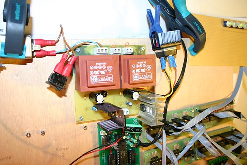

What are you using for power supply?
Could you put up a close up photo of your power supply ??
Thanks-
looks like he has built his own psu with two transformators and some additional stuff for regulation, to get the needed voltages for the core and sid modules.
You’re right thefRont, it’s a simple PSU. I can put PCB in the forum.
Here is a close-up of the PSU :
ludo
Thanks! Would love to the see the PCB layout-
How are you powering this PSU?
I’ll post the PCB layout latter because I’m away from home.
This PSU is powered on 220Vac (Main home power supply).
ludo
The Eagle file is here.
It is based on the Core design. Maybe 2200uF cap is a bit too low, but all boards have a 2200uF.
