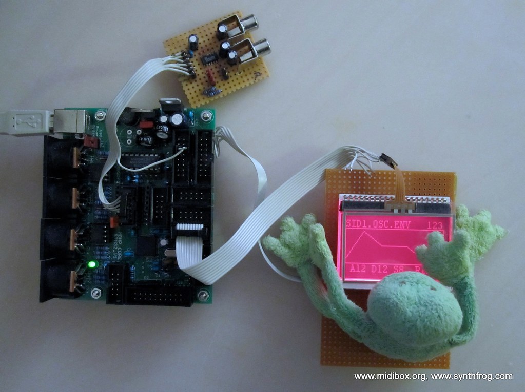

whowhopwhop !!!
i want that :
so TK, what’s your trick ? :w00t:
whowhopwhop !!!
i want that :
My guess is the display in the picture is a DOGXL160-7 with touchpanel.
Close, it is the EA DOGM128-6 (128x64). The DOGXL160-7 (160x104) is quite a bit bigger. Both are fully supported by MIOS32 :slight_smile:
