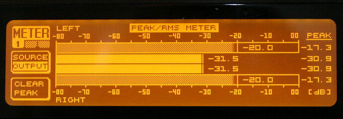

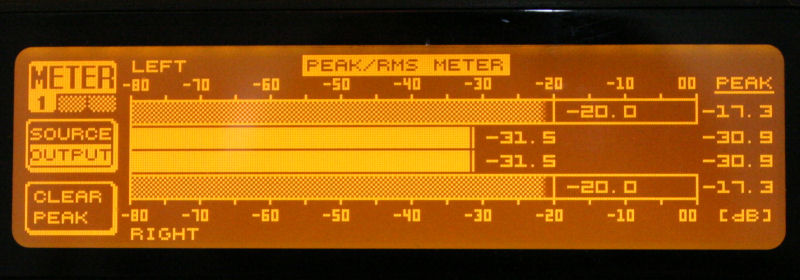

a little something posted elswhere, but probably of interest here - it turns out the led meters on the dcx2496 are indeed ‘rms’:
aprox -30db of pink noise with a 12db crest factor (aprox -18db peak):

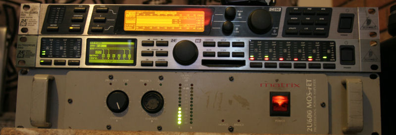

-30db rms shows up on dcx 2496 as an ‘rms’ value :slight_smile:
not peak !
however, this old matrix 2u600 shows the drive level as (-18db) peak:
