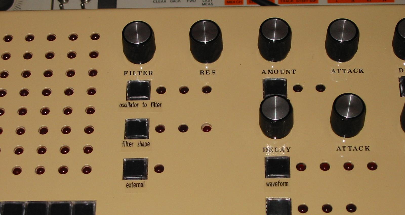

Just following up on this.. Incase anyone is looking at DIY text etc..
Here’s some pics of ‘letraset’ text which is labled under the knobs.. after I did this I sealed it in with a few coats of clear acrylic spray.
The others are from a stick on clear label maker.. both options very cheap… letraset was tricky trying to get it straight etc, as you can see in the pic.
