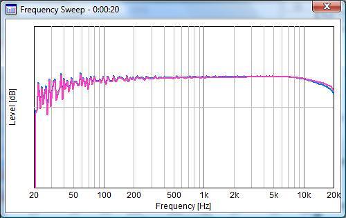

mod vs soundcard loopback, freq response 2db range:
as seen in the 2db range magnifycations, the modifyed version now essentially follows the input signal to total perfection, actual deviation is a fractional percentage :wink:

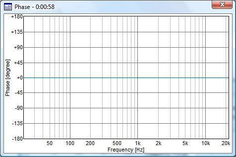

okay, so thats frequency response, so what about phase drift and distortion ?
Original Phase Response:
Modded box Phase Response:

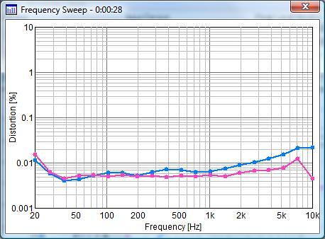

Mod vs Original Thd distortion:
Actually, this one just shows how the old box seems keener to run into distortion..
heres being fair to it & driving it lower down:
ony thing, is this only takes into account the addition of unwanted harmonics & ignores the collosal deviation of volume level over the circuits range ..if that was factored into the distortion measurment, it would look really ugly.
