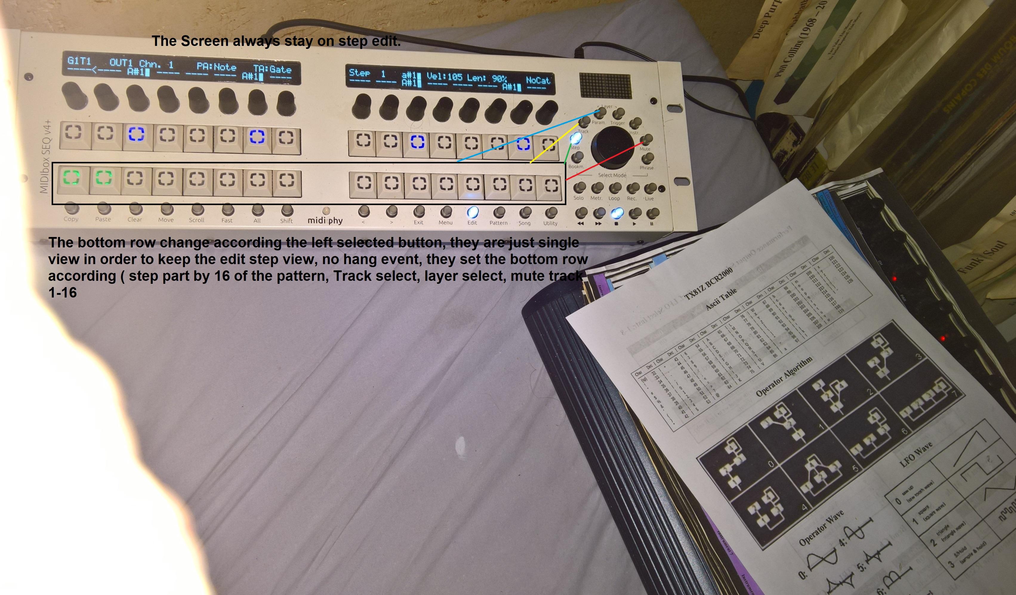

It’s the same thing with track, where the view choice is more arguable, but i think the most usable for me is the one switching bottom row from step part select to track select, then i just push back step to switch bottom row back to step part select!
Same for param the one with note vue meter and so on, just annoying, so i would prefer it like this:
Step button, i edit
Param, i change the layer from bottom button
etc..
Track button, i change the track from bottom button
Step button, i edit
all with just a push so each one would show only one view with no flashing or toggle of the not wanted one!
An incredible speed up in pattern making, also a way more less flashing screen, and far less complex button management!

I guess that you are still in the thought process, but if I understand you correctly, it’s sufficient to simply avoid that these buttons switch to their corresponding pages. Instead the 2nd GP row should just take over the selected function.
Here a trial which can be extended based on feedback: http://www.ucapps.de/mios32/midibox_seq_v4_098_pre9.zip
In your MBSEQ_HW.V4 file, add following setting at the bottom:
################################################## # Special Behaviour of some selection buttons of # the Antilog Frontpanel (to be documented...) # 0: default behaviour # 1: simplified behaviour ################################################## BUTTON\_BEH\_SIMPLIFIED\_ANTILOG\_FRONTPANEL 1
This will set seq_hwcfg_button_beh.simplified_antilog_frontpanel and I inserted a condition at some places, see:
https://github.com/midibox/mios32/commit/279a0e391f858a06e3409c7783d104ad5b2d1cd2
Please let me know if this goes into right direction.
