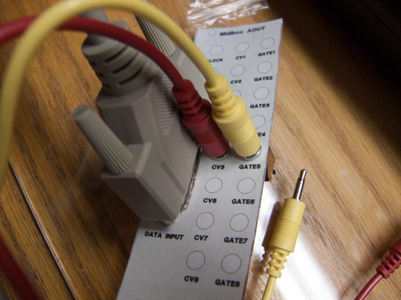

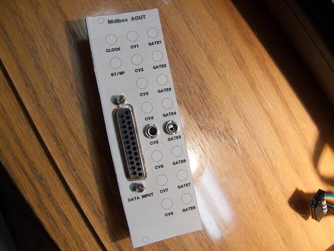

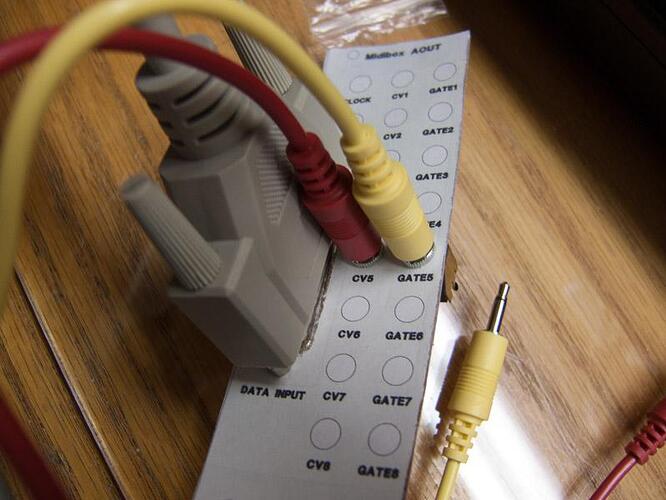

I created a cardboard mockup of the eurorack panel to check cable spacing and board placement. I think this 8HP design will work. The cable spacing is tight but certainly workable. This panel won’t be skiff friendly because of the way I plan to mount the circuit boards behind the panel. That’s not an issue for me.
Unless you’re already committed to the 3.5mm jack’s I’d recommend considering banana jacks. I’ve used 3.5mm ones in my modular at first but they’re almost all flimsy pieces of sh*t. The tiny nuts holding them in place tend to not grip tight enough or wear out…

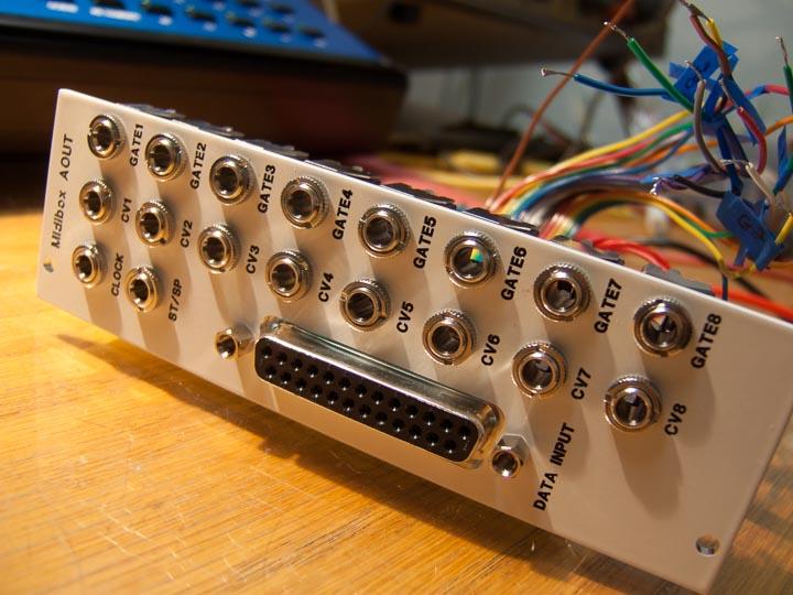

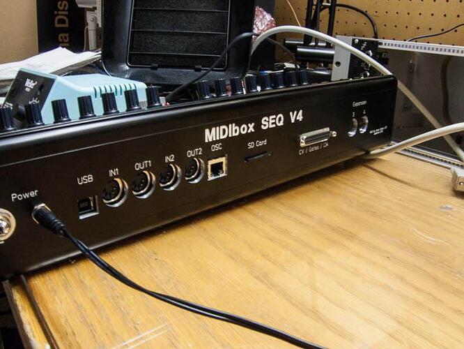

I’ve got an Easter update. The AOUT eurorack module is close to completion! I’ve got to do some tedious soldering and testing over the next week. Switching from the core32 to the LPC17 core delayed the project a bit. The switch forced me to redesign the back panel on my seq4 case and redo most of my ribbon cable connections. I received the new back panel and the eurorack panel this past week. Now I’m starting to cable up the eurorack panel. Hopefully I can wrap this work up in the next two weeks. Here are some pictures so you guys can see my progress.
I cabled up the eurorack panel and mounted it in a rack for testing. I’ve only tested CV1 so far and it’s looking good.
Done. Seriously. The midibox aout eurorack module works great. My quest to connect the aout_ng module to the midibox has taken me over 2 years to complete. I’ve learned a ton in the process. Like everything else with these midibox projects, I’m not sure I would have started this project if I knew it would take so long. :wink: I want to thank for giving me the idea to build the aout_ng module into a eurorack panel. Now that I’ve done it I can’t imagine doing it any other way. I replaced the core of my seq4 with the newer LPC17 core. I also replaced the green 40x2 lcd displays with blue displays from EastRising (www.buy-display.com). The box just looks amazing right now. I hope to produce a demo video over the next couple weeks so you guys can see the eurorack module functioning.
