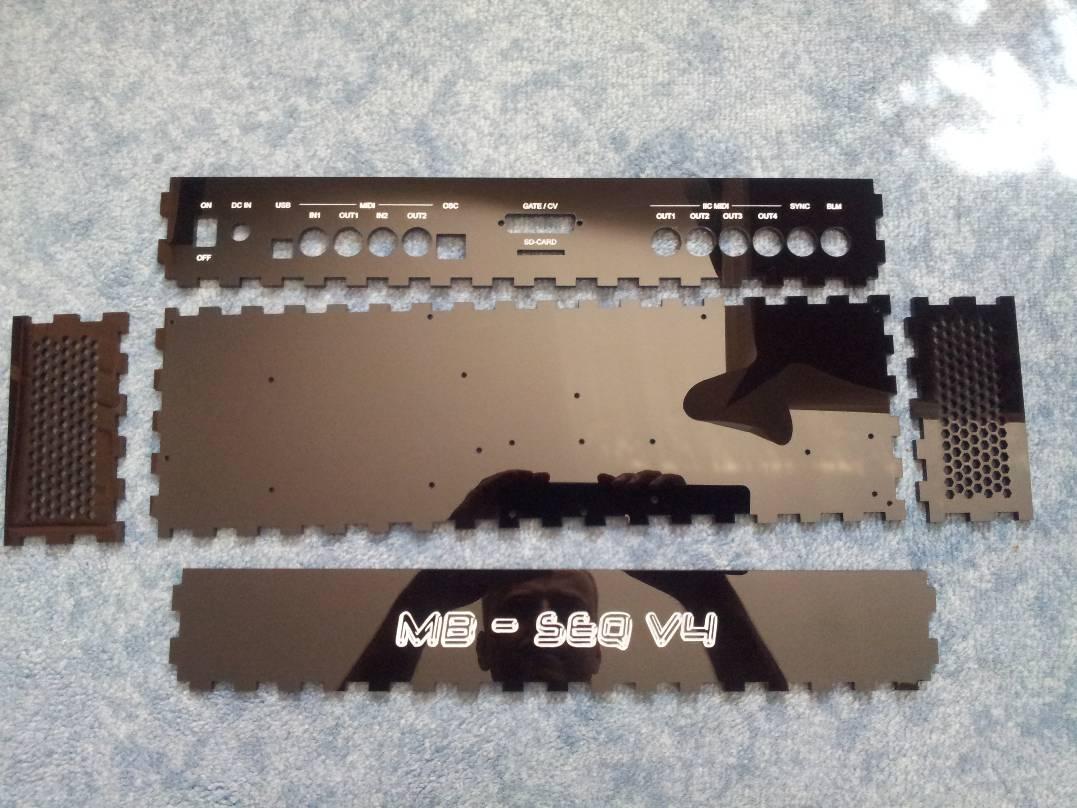

Acrylic case parts as they came from formulor (sorry…the holes in the buttom panel i drilled myself because of not having the correct measurements of all PCBs, but its the better way to drill them yourself because you are mor flexible using own made PCBs like i did with the SD-cardreader).

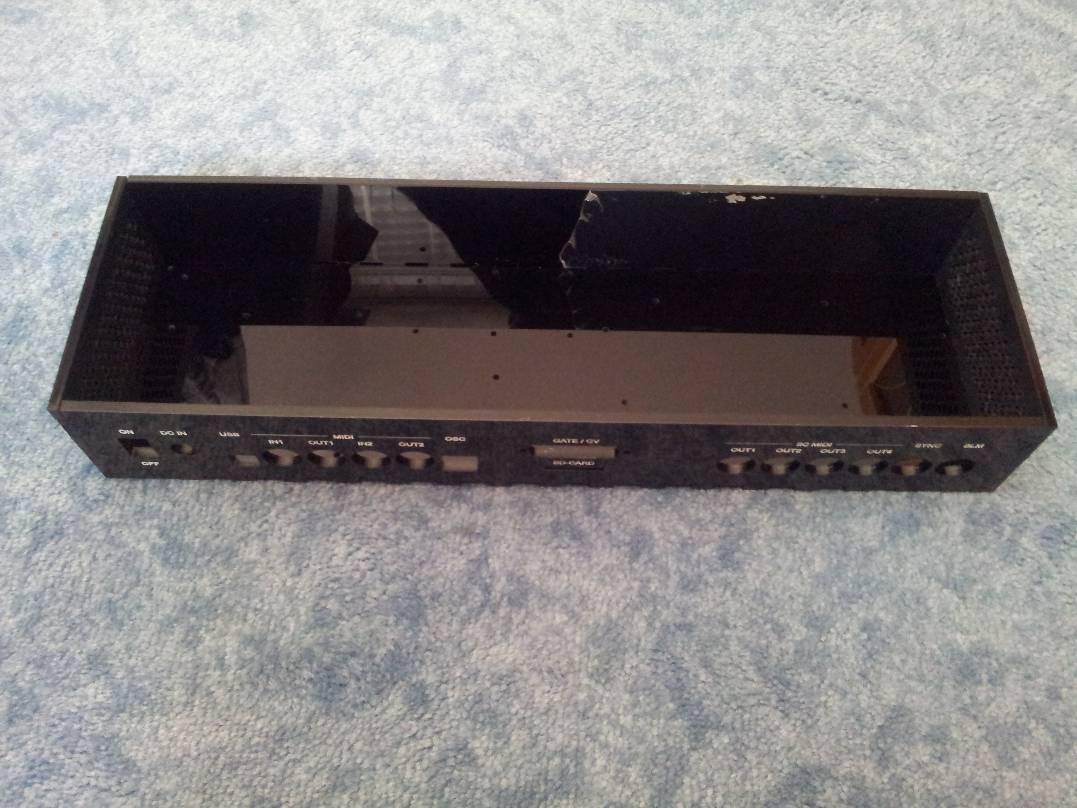

fresh with paint filled laserengravings…the paint filling i did myself…its very easy but you have to be quick to remove the paint that is to much with a soft and sucking tissue. not all the paint keep staying in the engraving by this procedure but enough as you can see! :slight_smile:

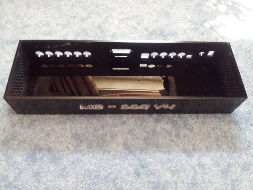

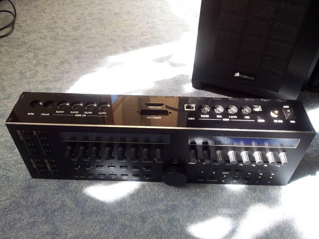

a view from the back-top

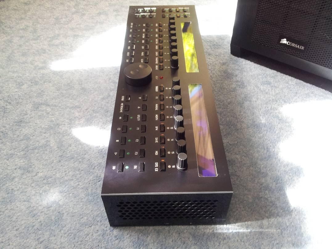

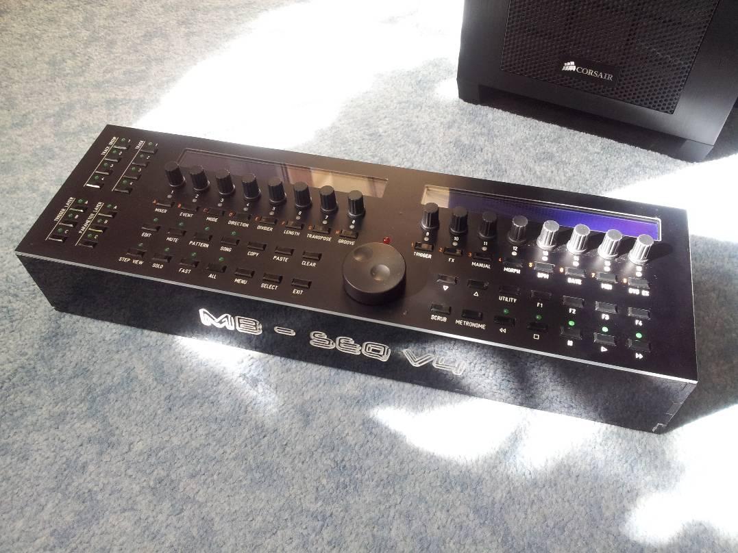

complete SEQ V4 in the new 5mm black acrylic case with standard wilba-aluminum-frontpanel
20130901 111002
20130901 111037
20130901 111116

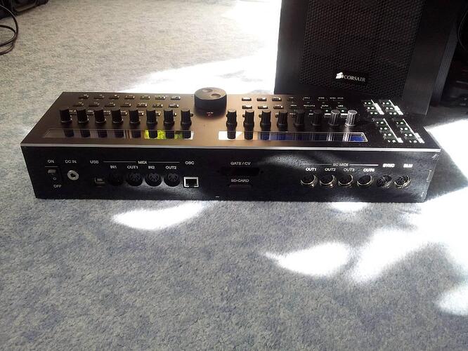

Re: 20130901 111116
nice job!
