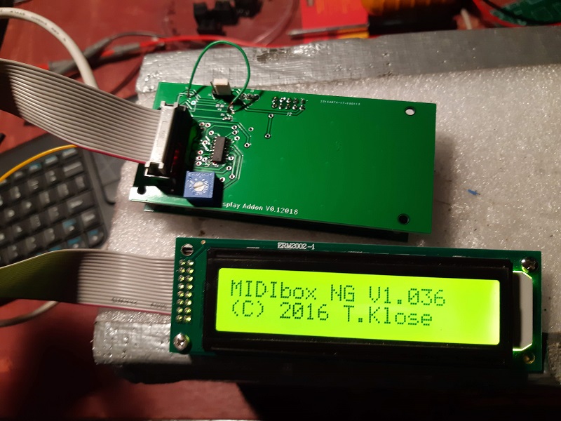

I made a display addon for this minimal core. This was my first attempt at Eagle and while the resulting PCB had a few errors I was able to kludge the first version and get it working. The display addon snaps into the original minimal core board with standard .100" male/female headers. I also made a reduced Midi I/O with a thru section using TRS jacks, (thanks Andy for the footprint) this also works well. My goal is a small scale SCS box to run a small synth switcher/routing unit.
I will upload the files when I’ve time to fix the errors.
@Fantom XR thanks for the core board and inspiration.
