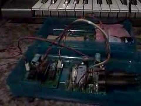

First sounds from mbSID:
6G7gmJRN120
Construction photos:
