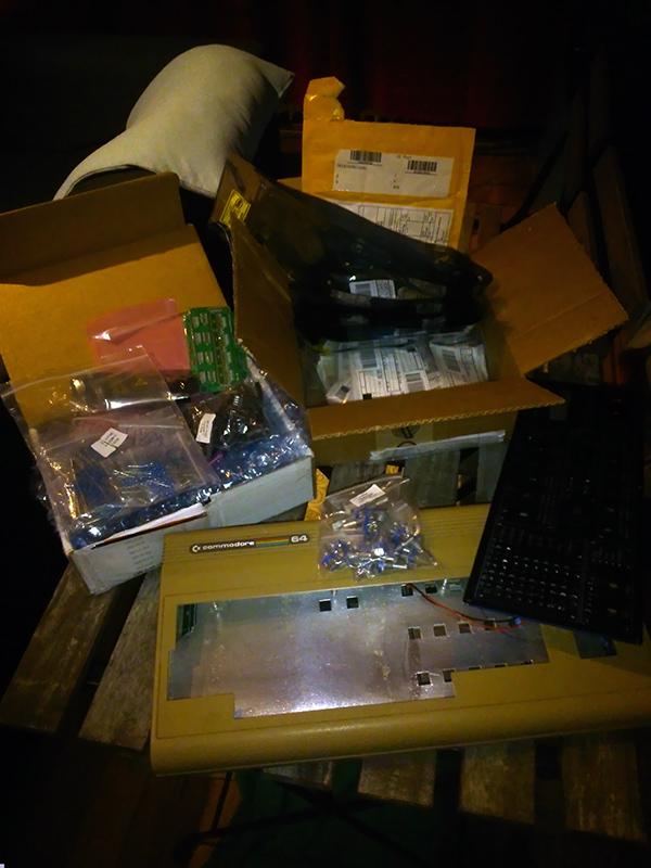

IMG 20141207 010942
An old european C64 donated to me from an old friend

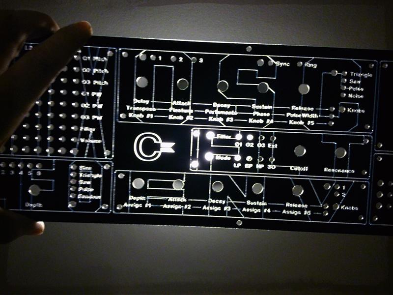

IMG 20141023 223902
First version of the front panel. The final version will be better, including a proper Commodore logo.

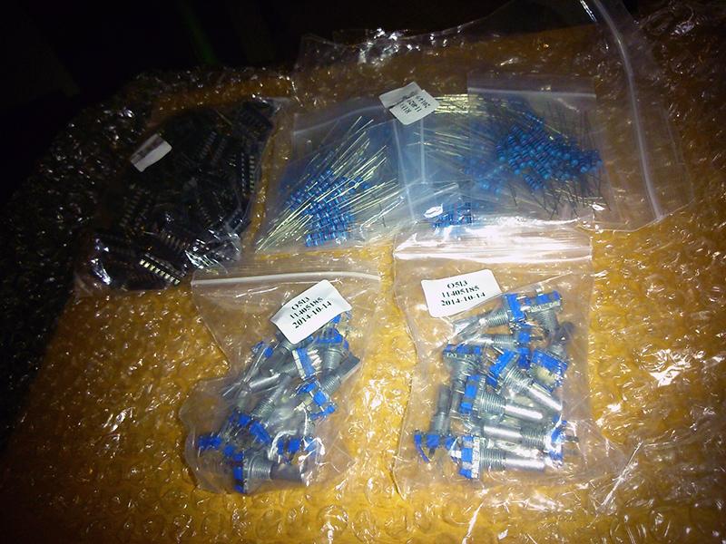

IMG 20141106 223956
First order of parts. DIL sockets, resistors and rotary encoders from China.

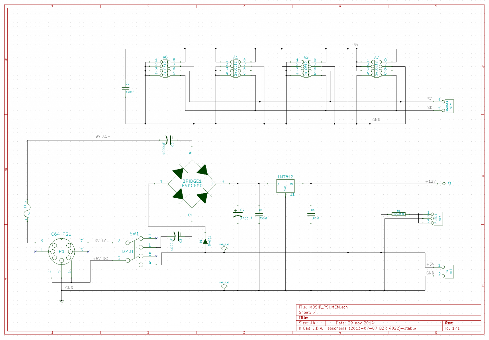

AISID PSUMEM schematic
Schematic of my PSU 12V regulator & bankstick circuit.

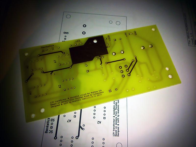

IMG 20141206 165735
12V regulator & bankstick PCB

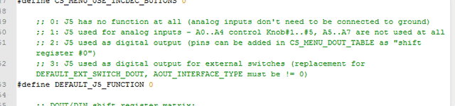

default J5 function
No default function for digital input to be seen… :frowning:

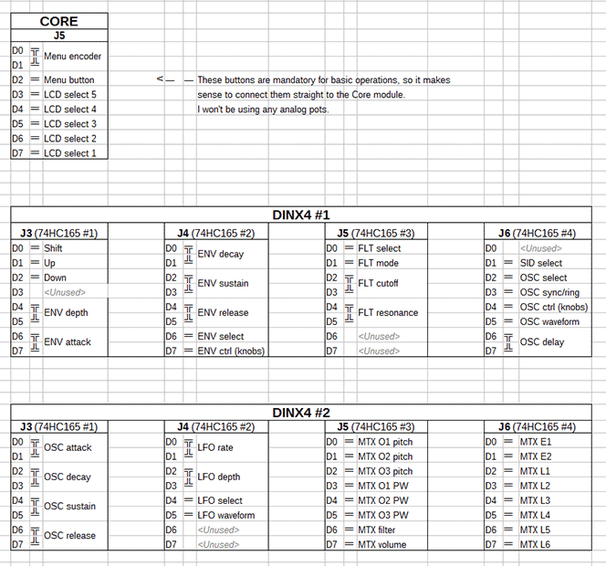

DIN pinout without J5
Revised DIN pinout with J5 removed.

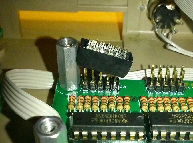

DOUT IDC plug
Dammit!

Re: DOUT IDC plug
nimm eine Kunststoff Distanzhülse und schleife ziemlich viel weg… wennst ka zeit hast nimm an schleifbock
take a Distance-bolt and file one side away until it fits… take a floor stand grinder if you want it faster
