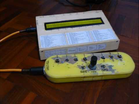

Are you using a c64 power supply for it, or just some other PSU with a DIN connector?
I’m using just some other PSU with +5/+12/-12 V that for some reason has a DIN connector. When I sleep I have nightmares where I am connecting it to one of the MIDI plugs.
very cool, the external controller! would you like to show some pics from inside?
and how did you wire it?
Yay, I’ll make some pictures! The wiring is simple… since you just need to connect a DINx2 to the core, you need only 5 wires. A MIDI plug has just the right number. So I basically connected the DINx2 which is in the “joypad” to the DIN connector on the core. All connections to buttons and encoder are inside the joypad. (The orange cable is a piece of network (ethernet?) cable.)
