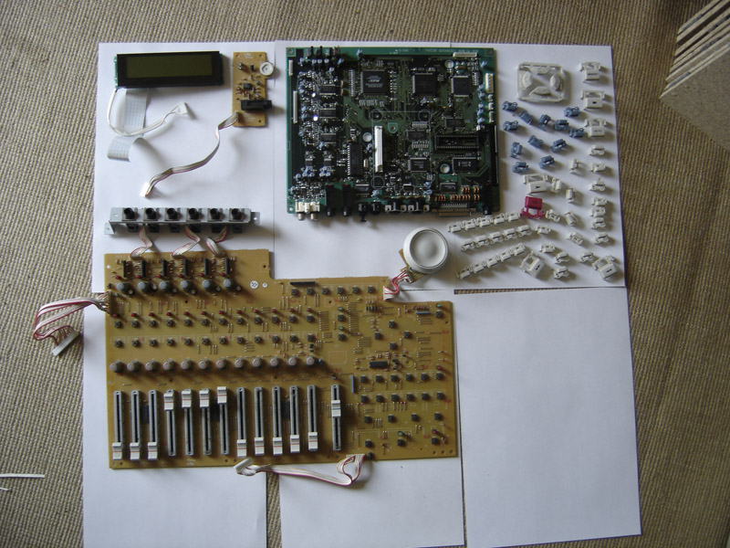

I just remembered I had an old, broken Akai DPS12 (multitrack harddisk recorder). So I decided I’ll try disassemble it for parts, which will save me some money. It’s got a whole lot of buttons, 13 faders, 18 rotary pots, a rotary dial (like the mpc), and a graphical LCD.

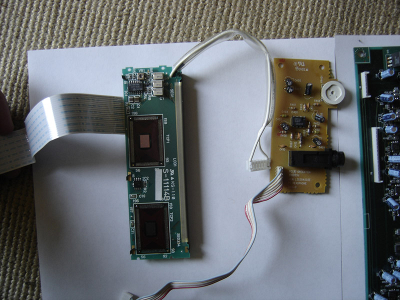

My question is, how easy would it be to desolder the required parts? And will I be able to use the graphical LCD? It’s got S-11114B written on the back, not sure if that is of any help.

I’ve attached a couple of photo’s from the disassembled DPS-12.

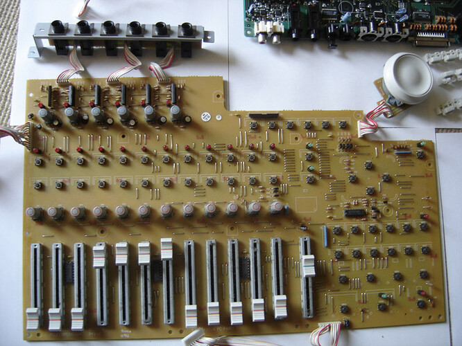

Fall_X, nobody but you knows will you be able to desolder parts of the board. I advise you to practice on some junk you don`t need. When You build some confidence you can try this Akai board. Bare in mind that too long heating of pins will damage most of the components, especially mechanical. It would bee really shame if it happens. Did you check is those pots linear, and what is their value? Also LCD… graphical displays are supported but it depends of the type of controller. They are not all same.

On the pots/faders, you should first try to look for a label printed on them. “B” *should* indicate linear (or A for log/audio), along with their resistance value (B10K for example). Beyond that, I guess you’d have to check the resistance with the pot set at different points to figure out if it’s close to a 1:1 linear curve or not.
On the LCD, again, some of the IC labeling would probably tell someone here what they were (if they’re anything common) along with the number of connections.

The control surface should be no problem - it’s single sided. Just use a decent iron and one of those plunger type solder suckers. If you are right handed, it’s best to hold the iron in your left hand, let the solder get well melted then suck it off with the remover in your right hand. If you find that the solder doesn’t take up the heat easily, using a small dab of fresh solder makes it easier.
You can often ‘wiggle’ the desoldered pin with a pair of needle nose pliers to make sure it’s loose.
The double sided board is another problem: more for experts. I have salvaged motherboard ‘jungle’ chips the way I’ll describe, for a vital repair, but it is a nasty job, and has health risks. If you want to get into this, my recommendation is for a heat gun and practise on a few old motherboards first. Trick is to get the solder on the back ‘runny’ with the heat gun at close range, than give the board a sharp knock, and watch for the shower of chips. Do it over a protected surface! A heatproof glove, (welders or hot handlers Kevlar) is a good idea. Plenty of ventilation too, the fumes from the hot PCB material are not good.
