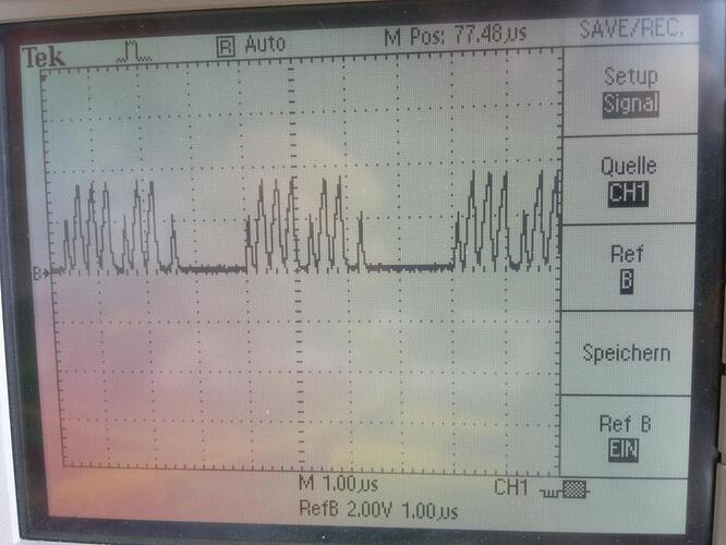

I just scoped the signals between µC and MCP3208 and they look a bit strange I think.
I attached two scopes of the Clock Signal, one with a Time base of 250 µs and the other with 1 µs. Is that how the Clock is supposed to look? I rather thought of a square signal…
I used 3,3V –> 5V levelshifting and the Signal doesn’t even reach 4 V.
The other Signals CS and Din also don’t reach 5V.
Regards, Simon
No, this isn’t normal.
The clock should look like in this snapshot:
Do you also notice such a “weak” signal directly on J19 when the AINSER64 module is disconnected?
If yes: then the problem is related to the 74HCT541 (IC1) - check that this chip is correctly supplied at 5V
If no: then the problem is located at the AINSER module
Best Regards, Thorsten.
Wow, thanks for being so kind to measure the signal on your core. And so quickly… appreciate that.
I should mention that I’m using the STM32 Core. So there’s no 74HCT541. The MCP3208 is controlled by the STM directly via pull up resistors on the SC, SO and RC lines.
If I disconnect the MCP3208 so that I can measure the signal directly, it looks the same as before, so it seems to be a problem of the µC. I checked all the Vdd voltages on the stm32. They’re all at 3.3V so everything is OK here.
I have no idea what else could be the problem… :no:  Maybe I should try and configure the outputs in push/pull mode and see if I get the right signals. The MCP3208 should be able to handle 3.3V signals, right?
Best regards, Simon
You are using a STM32… this was an important hint! :wink:
Yes, please try it in push-pull mode at 3.3V.
(set “#define AINSER_SPI_OUTPUTS_OD 0” in your mios32_config.h file)
With some luck, the MCP3208 can still be supplied at 5V, which gives you a larger voltage range for the pots.
So, try both options: J26 set for 3.3V or 5V

Switching to push-pull mode did not solve the problem. The signals still looked weird although now with a level of around 3 V.
Next thing I tried, was to change the SPI peripheral that was used to J16 instead of J19 (changing the “#define AINSER_SPI” hook in ainser.h to 0) et voilá, it works. AINSER_jitter_mon now outputs jitter values of up to 7. Not perfect, but I’m happy for the moment.
Looks like my PORTB or at least the outout transistors are damaged, for what reason ever. My J5 input pins connected to PORTB however do work.
So now 'm gonna use J16 for AINSER.
