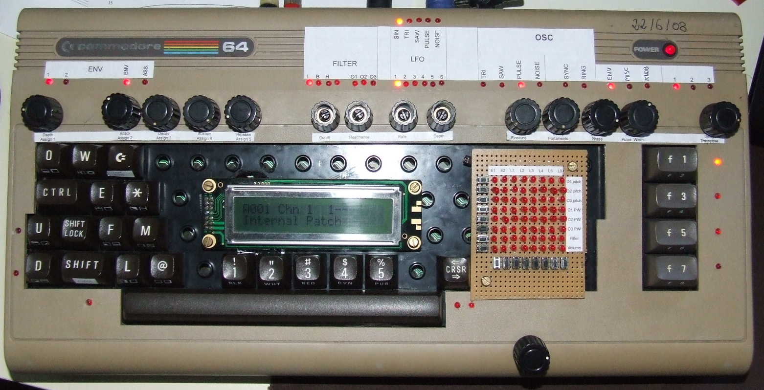

Somehow with my year of looking at different midibox sid creations, I missed this guy until yesterday, who did something very similar to what I’m planning except I’m not doing a matrix and plan to have my knobs in the keyboard area:

So I’ve ultimately concluded that its not possible to put a MB-6582 in a C64C case while retaining the keyboard (with its PCB attached) because there’s not enough vertical space at the front to fit the MB-6582’s components. So I’m going to install the synth in a re-labled VIC-20 case. Since I now have an extra 64C case and a keyboard I’m also going to put together a Raspberry Pi “retro” gaming system. :slight_smile:
