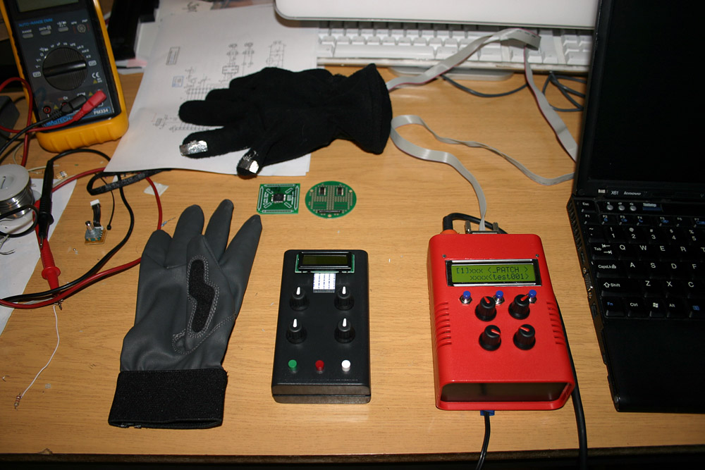

Prototype 2 is finished.

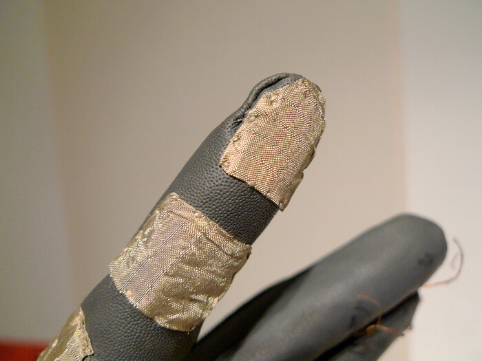

This is the build process of the glove itself. I used headphone wire inside because each strand is coated with plastic and there’s a strong nylon thread core. Hopefully it’ll stand up to gigging!

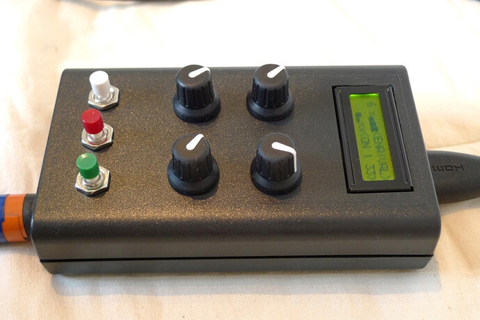

Part 2 - building the MIDIbox core.
I used a 40-pin tqfp surface mount PIC18F4620 and crammed everything inside this tiny case.
I chose an HDMI connector from the glove to the MIDIbox because I have 10 DIN’s, 6 AIN’s plus power and a single LED DOUT (18 wires):

What I did here is definitely not new, but part of a long tradition of hand-oriented instruments. I researched various gestural interfaces and came up with something that fit the dexterity of my hand and felt as intuitive as possible for my purposes. It’s also a lot smaller to bring to gigs than a keyboard or guitar :wink:
4 fingers triggering 8 notes against an opposing feels very fluid, especially when you optimize the note-layout to thirds, fifths, etc. Complicated rhythms aren’t so difficult. Whatever articulation that’s lost from having to have all my fingers hit the thumb to trigger notes is fully offset by a myriad of interesting and more natural strumming possibilities that are otherwise impossible on a finger-drumpad.
