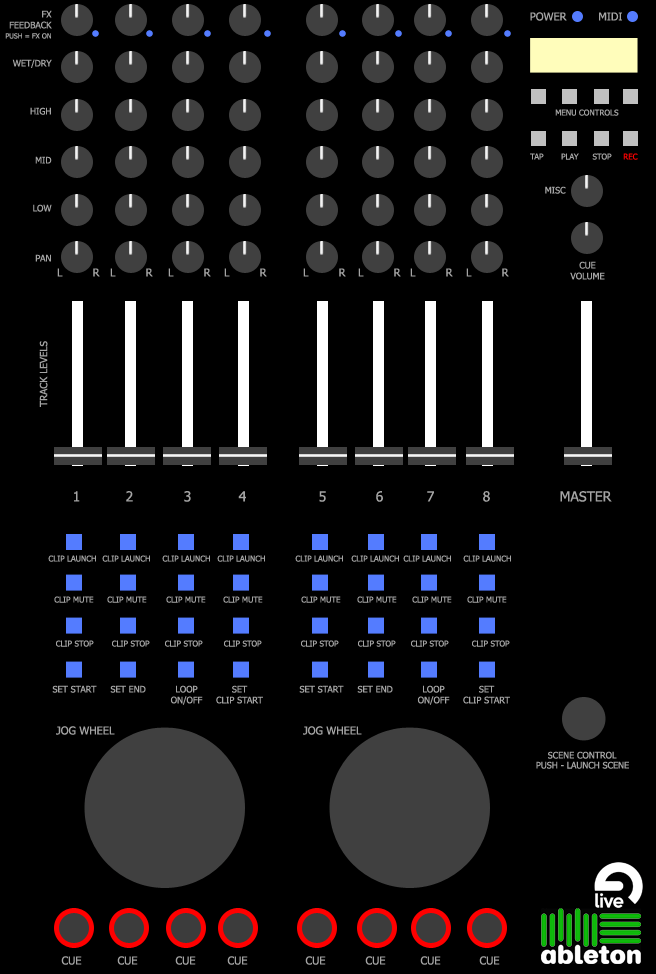

I am currently planning the layout of my own Live controller.  It will be based on the midi section of a Xone 3D (see pic http://www.xone.co.uk/images/Hi-Rez/3D_top_overlays.jpg).  I will finish off the layout design and upload it along with button labels later today.
Joost
53 pots
9 faders
57 buttons
50 leds
the design is fairly self explanatory (see labels on buttons).  the blue parts in the middle are pushbuttons with integrated leds (illuminating when a clip is playing), and the red parts on the bottom are pushbuttons with circular led lighting (illuminating what channels are sent to the headphones).  the scene control button can be used to navigate through live’s scenes and pushed to launch the scene.  the top row of pots can be pushed to turn on/off the effect.
i am planning to route channel 1-4 to Send A and 5-8 to send B and then with the jog wheels i will be able to control the effects that are layered on the 2 returns.  this way instead of using effects on all the channels i am using only on the returns (with exceptions of course) which will save cpu power - and mimics the way a xone 92 mixer works.
anybody have any comments/ideas?
Hey Joost, wellcome aboard. You chose nice reference for you design. Xone92 is one of the most seriously looking controlers. Very tasty and clean design. I have one sugestion regarding you design. I would rather mark the section “clip” than repeat so meny times Clip Lounch/Clip Mute/Clip stop. Visually looks bad. About other things I cant complain, as it suits individual needs, as you said.

so there are a couple significant differences here.  first of all you are incorportaing a crossfader, which i was also thinking of doing, but then just opted to use only the upfaders of the individual channels.  why are you incorporating an x-fade?  is it when you are using the controller to mix mp3s together?
secondly you have 4 sends on each channel, how are you planning on using this kind of setup?  will you have control on effects parameters with this kind of design?

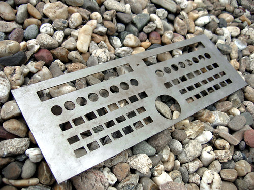

I wouldn`t sugest using Photoshop for designing panels as it is made for bitmap graphics, not vector.
Friend designed his box using Photoshop, and I needed to rebuild hole thing in Corel Draw as vector so it can be send to CNC service. You need to have ability to numerically change dimensions, to align objects, etc. The output file is usable on anny CNC machine. I am mostly using laser cutter. Panel on picture is designed in Corel Draw and it is waterjet cut. The result is precisely cut 1mm thick steel. It is waiting to be airbrushed and screen printed.

Man, don`t drill it, mill it! I would never made those boring fader stripes by hand again, NEVER! I use my hands only for things I cannot do easier way.
Sure, Illustrator, Freehand whatever… vector is vector. As already said, maybe you should save your draving as DXF or something else. Check what they use. Pay attention on lines width. It must be hairline for cutting!
