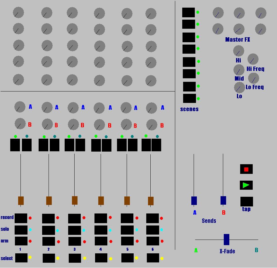

Hey I’m working on an Ableton controller for a senior project (part of our curriculum is to do a project that we work on all year).  I have had many sketches and lots of crossed out stuff and added stuff, and finally I have come up with a design that I think I’m happy with.  However, since I am new to this whole thing I’m wanting to know what you guys think.
It has a total of 62 analog inputs (9 faders, 53 pots) and 47 buttons, so I should be okay with using a core, two AINs and 2 DINs.  There will be 44 Leds for the buttons so I think I can get away with just one DOUT.

After searching and reading around here, I notice that most people use encoders for tempo.  One other thing I saw was two buttons for +1  -1  tempo.  Are there any other ways to do tempo b/c I don’t wanna use an encoder since that requires buying the MB64e as well (right?).
Tell me what you think.

heya… Just a few tips: Pots and sliders are analog, but the buttons are digital, but the mb64e supports both pot/sliders and encoders simultaneously.
Hope that helps :slight_smile:
As in, the MB64 would not accept both a DIN and an AIN?
MB64 supports DINx* modules, but not fir encoders. Check this out:
http://www.midibox.org/dokuwiki/doku.php?id=questions_and_answers#what_s_the_difference_between_pots_sliders_motorfaders_and_encoders
You can easily add the code for additional encoders to the normal MIDIbox64 application, it’s done in the same way like for MB64E: define the encoder pins in mios_tables.inc, and add a routine which sends MIDI events on encoder movements to USER_ENC_NotifyChange, thats all
Best Regards, Thorsten.
NOW I AM CONFUSED!
Someone told me that I HAVE TO use MB64E if I want encoders (specific 2xScratch dials, 12xEffect “pots”).
