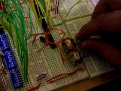

While looking at fairly simple cymbal circuit of tr 909 clone I got an idea of building few rompler modules with various percussion samples. It could be a cool extension to MB808 project. I started to search for some info about 27C256 EPROM and how to convert audio to hex so it can be burned into chip. So, I stumbled upon very interesting project by Sebastian Tomczak. He already did some diy rompler. In his A True Rompler 1 he was playing an loop, and in version 2 he burned 8 note loop and he can play the individual parts of the that loop which is much better than I thought it could be done. What I was expecting is 1 EPROM 1 sample. Here are his page and videos:
A True Rompler 1: http://little-scale.blogspot.com/2008/11/true-rompler-1-raw-digital-audio.html
A True Rompler 2: http://little-scale.blogspot.com/2008/11/true-rompler-2-drum-machine.html
