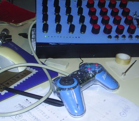

in a flea market, i found an old playstation 1 joypad for 2.5 euro… it has a lot of buttons!
i opened it, removed all the chips, resistors, and so on, and i simply directl connected every single button to a midibox 64E DIN input using an old PC parallel port cable!
not too difficult, indeed!
now i use it to trigger notes events… a strange way to play but, neverthelss, funny and cheap! :wink:
PS: i assigned notes events to the different keys completely random, based on a natural C scale (C,D,E,F… no accidents). playing basslines and synth lines “randomly” may be inspiring!
after the first “games”,  i decided to use this thing as a “Live controller” to automate the sequencer… now i can play/stp/record/move thru measures with this joypad! :wink:
