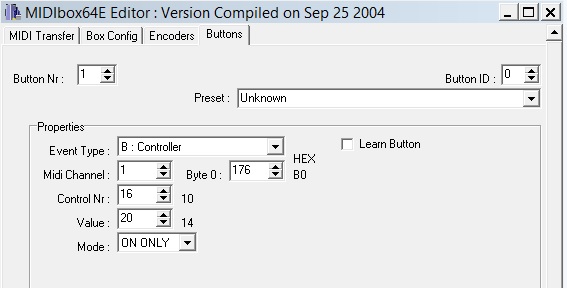

I am right i can do this as the rotary switch is attached to the Din input and i can just either edit the assembly or if I remember rightly you can use the mb64e editor to set this value.
Just digging the parts out to try it anyway, will post how it goes!!
Update: All sorted I remembered correctly, I can set it in the editor and save it there. That is the last thing i needed to check for this build. Happy solder geek :wink:
