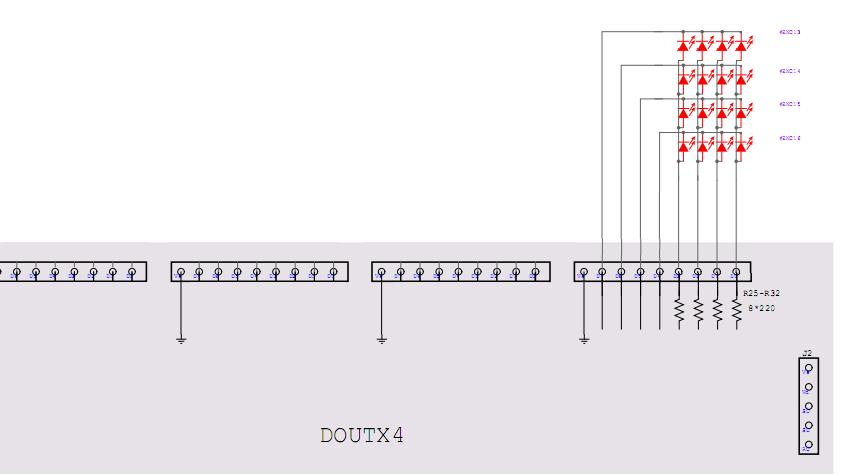

Hi Everyone
I wanted to know if the attached 4x4 LED matrix wiring schematic would work. I know i would have to Rewrite some code and stuff. Or will i have to stick with the traditional LED matrix wiring (http://www.ucapps.de…x4_ledrings.pdf) and use 2x 74HC595. Im trying to reduce part’s count on my new project.
Thanx for the Help :smiley:
You will built the matrix with the 2x 74HC595 i-cs.
Regards,
Janis
Should work with the appr. code! :slight_smile:
