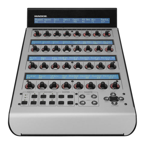

I am dreaming from this… all the time… but way too expensive…and… I only need one 2x40LCD, with 8Encoder and 8LEDrings under it…
Is it, or will be the 2x40 LCD supportet…or 2x 2x40 or 4x 2x40  ;)  why that? When using Midiboxes with software, you have always the problem…“the setup, is changig from week too week, and also the plugins…” And when you make a frontpanel with text on it… after a week, the text isnt true for your setup… and a big lcd in combination with ledrings and encoders gives you workflow…
I would need it for remote for my jomox airbase… that is that analog baby:
I would like to make that of it:
the MB808 as sequencer, and the Midibox 64E? as cool total recall interface, with good workflow
you have 9 Instruments… and with every instrument you have other Controll names… you could make it like waldorf in a Text- Matrix and LEDs next to it (like by the sid with “ENV, MISC, … 2nd function…”)

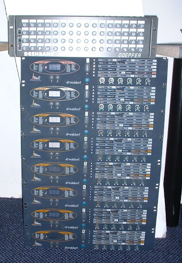

And I also need it for my Waldorf pulses… the waldorf matrix with the Potis is worst…and If you use the Waldorf Pulse as Poly (2 pulses are needet) you must edit all parameters twice…
look @t that,isit cool?
ok I have only 2 of it, but instead off the doepfer drehbank I would have a cool Midibox  :smiley:
So Snapshots would be cool, to save all, like synthspresets  ;)…the pulse have “only” 99 of them…  ;D

Hm, the LC does the "Logic/Mackie " job, with the commonication by computer…the computer sends Names, for the selectet Chanalstrips and so on…
So the LC does the same job like the MB64E? I meen, there A knobs, and LEDs that switch and displays, on what Layer (midicontroller row) I am now? And I can self Name the Controllers in the Display like " Attack d s r, OSC1 tun OSC2 tun…" ? or do I need a Host software, that have the brain? I meen, my waldor pulse has no mackie emulation  :wink: in it…

Sure you can use the C code from the LC. But: The LC interacts with the Machie-Protocol. You only can display what the host sends you via Mackie-Protocol. You won’t be able to emulate a C4 with this. If somebody “hacks” the C4, maybe then there is chance to build a Midibox-C4.
A Midibox64e isn’t also a solution, because your host won’t send the labels via midi.
I never got my hands on a C4. One reason for this is that only a few hosts are supporting this unit. My Cubase won’t. Thats why I don’t have a C4.
